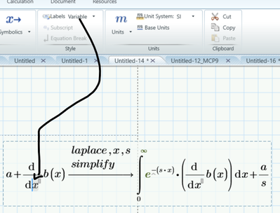

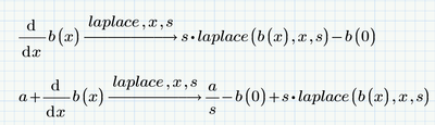

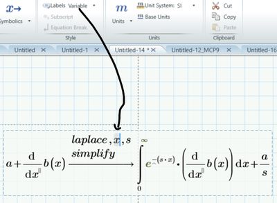

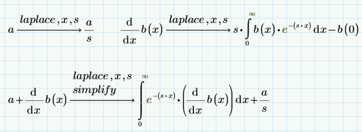

Why when I added a constant value a to a derivative I see that the laplace transform of a derivative did not work as expected? Am I doing wrong something? Or?
Prime 9 sheet attached..

LucMeekes
(To:Cornel)
It seems like the derivative of b(x) is sometimes not recognised as such.
Check the labels of your variable, especially the x'es. All your x'es should be of the same label.

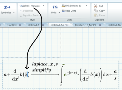

I checked x-es labels...they are the same:

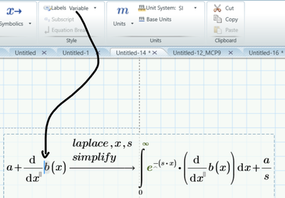

LucMeekes
(To:Cornel)
Still there is a different one. the (x) between brackets is a '(variable)', not a 'variable'.
If that doesn't help, file a bug report.

Yes, but look, the laplace transform with same (x), so '(variable)' not a 'variable' run without problem when removing that constant a:

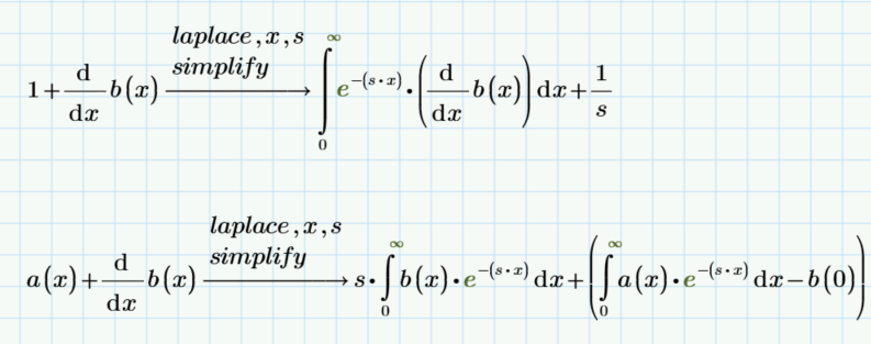

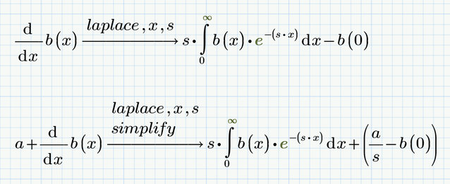

(To:Cornel)
As Luc already wrote - report it as a bug to PTC support.

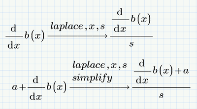

BTW, P9 is still a little bit better than P6 where we see this (the derivative is treated as a constant!):
EDIT: Sorry, the above was due to Prime's autolabelling bugs which were even worse in P6 than in P9. After manually labelling the variables we see
So what you experience in Prime 9 seems to be a newly (after P6) introduced bug which should be reported.
In case you are interested - the legacy engine in P6 (muPad) gives us
