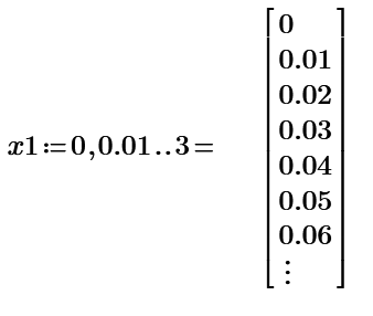

Why the result of an index value of a vector defined with Step Range/Range is limited at 2 decimals?

OK
Not OK?!
Should not be
Cornel_4-1695819023951.png?
x being any number
Not OK?!
Should not be
Cornel_7-1695819080595.png?
x and y being any number
Best answer by Werner_E
Turning on "Show trailing zeros" globally should do the job
Try the attached file
September 27, 2023
I guess Prime does not show trailing zero's.
Werner_E25-Diamond IAnswer
September 27, 2023
