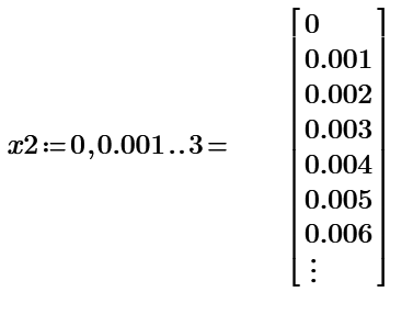

Why the result of an index value of a vector defined with Step Range/Range is limited at 2 decimals?

(To:Cornel)
Turning on "Show trailing zeros" globally should do the job
Try the attached file

LucMeekes
(To:Cornel)
I guess Prime does not show trailing zero's.
(To:Cornel)
