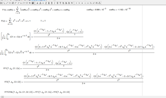

I have searched the community and only find wrapping long equation and not symbolic answers.  This works, but I was wondering if there was some built-in way to wrap symbolic answers similar to wrapping long equations, which I don't recall ever doing.  "No" is an acceptable answer.😄
Thanks as always.
Best answer by terryhendicott
Accurate prediction of the answer  - no.
But you can as you have done turn them into a function.  This can be achieved in the one line so you do not need to copy and paste the symbolic equation result.
Cheers
Terry
