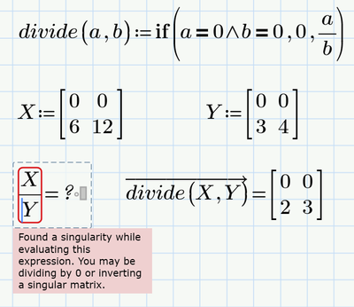

After Mathcad 15 worksheet conversion into Mathcad Prime 9 I'm getting an error:
Please help. Mathcad 15 did not produce an error on those matrix division.

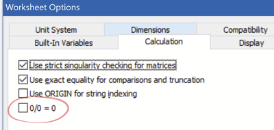

Best guess is that in MC15 in the Worksheet Options the option 0/0=0 is checked.
As far as I am aware there is no comparable option in Prime.
A possible workaround could be a small utility function which is called vectorized:
