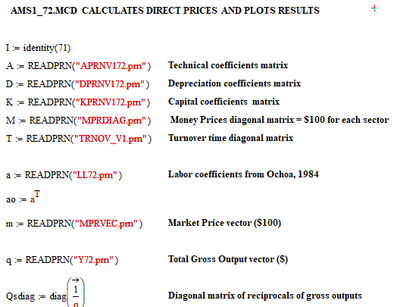

This file (AMS1_47.MCD) is not much different from the previous file. This file also depends on a number of external data files (.prn files). Here is how it starts:
And Vladimir provided the Prime conversion, which does open in my Prime 7 Express:
If you have the corresponding data files, then it may be worthwile to edit the READPRN statements so that they refere to the data files in the correct Prime way and see if all calculates.

The file is a (real) Mathcad 5 file, and it appears to calculate alright,
BUT: It needs the following datafiles in order to have data to work with:
APRNV172.prn, DPRNV172.prn, KPRNV172.prn, MPRDIAG.prn, TRNOV_V1.prn, LL72.prn, MPRVEC.prn and Y72.prn
Here's the start of the file:

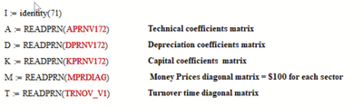

Hmm, when I open the MCD file in MC15 I see this:
That is I see
APRNV172
and not
"APRNV172.prn"
So I see variable names and not path-strings, which was the reason I suspected that the file would be an include file of a larger project.
Does it mean that MC15 is making this error when opening a MC5 file??

If you look into the file, it only has the names for these .prn files. I guess back at the time, and in Mathcad 5, given that each filename is an argument to the READPRN function, the extension .prn was implied. That 'policy' must have been abandoned somewhere.

Its not only the extension prn which makes the difference. The main difference I see is that MC15 does not show any string, so it has to be assumed its a variable name. I your picture (I guess you opened the file with MC11) I see nice quotes making up for a correct filename argument.
When I look at the file with  a text editor, I see
{0:I}NAME:{0:identity}NAME(71)
.EQN 3 0 1 0
{0:A}NAME:{0:READPRN}NAME({0:APRNV172}NAME)
.TXT 0 27 2 0
So it looks to me that APRNV172 actually is meant to be a name and not a string but I don't know how a string would have been represented in that old format so I can't be sure..
I wonder where the quotes and the extension prn in our screenshot stem from. Do they stem from MC11 or did you add them manually?

If I remember well, Mathcad 5 didn't know strings. You just supplied the file name as an argument to the READPRN function and it would use it as the file name, the .prn extension must have been implied.
