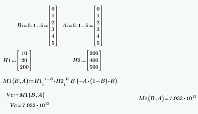

First of all, you don't really have a vector.
Because you define A and B as range variables, your formula computes; but if you try to define a vector (Vc), the program throws an error.  You can turn A and B into vectors (an undocumented and dangerous practice) by putting an "evaluation" equals sign after the definition; but the results aren't what you'd expect:
Why?  Because A and B are both vectors, so the multiplication signs in the equation are interpreted as "dot products," and you get a single value answer.  You can "vectorize" the equation (means evaluate for each set of values in each vector) and get:
But that's still not what you want.
I'm not sure how you would get a 3D plot in EXCEL; but in Mathcad you'd use the function "CreateMesh" to create a (very large) three column array (AKA matrix) that you'd then drop into a 3D plot.

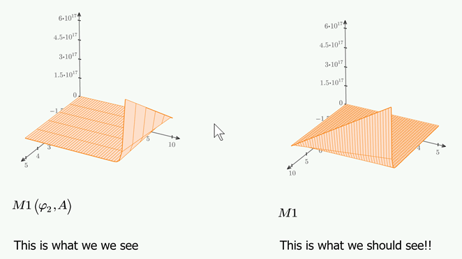

BTW, what we see in the sheet is a severe bug in Primes 3D plot!
The function arguments are mixed - the first, phi2, is a free, unassigned variable but the second, A, is  range from 0 to 5. So we would expect to see the x axis from -10 to 10 and the y-axis from 0 to 5. In first sight the opposite seems to be true but on second sight the catastrophe: Prime exchanged x- and y-axis!!!!
That axis reversal is OLD.
I pointed that out during a beta review (back when Mona was still here.)  Shows how much I use 3D plots!

I wasn't aware of that bug in Prime. Shows how much I use Prime, I guess (not at all, except to answer in this forum).
It seems to have to do with the new syntax which in Prime is additionally allowed. In real Mathcad you get an error if you enter the function name PLUS arguments in the 3D-plot placeholder - no matter whether  those arguments are defined as ranges or undefined variables.
Anyway - one more reason to control the output of a 3D plot only via CreateMesh - its more convenient and secure.
