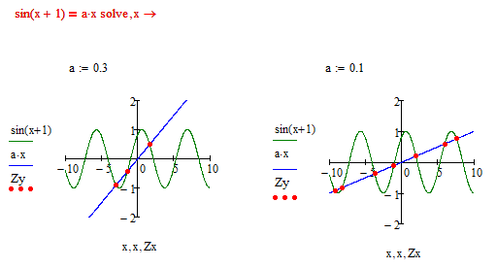

Why do you think that a generic symbolic solution would even exist?
You won't even find a symbolic solution for a much simpler equation like sin(x+1)=a*x

O don't think that a closed symbolic solution for your equation exists, but if it does, it sure would have to contain a myriad of "if's" concerning the other variables and their values with respect to each other.
The simple equation sin(x)=a*x+b can have (depending on a) none to any finite number of solutions (but not infinite!) if b>1 or b<-1, but it can have at least 1 up to infinite solutions if -1<=b<=1.
How would all these cases be expressed in one single symbolic solution?
