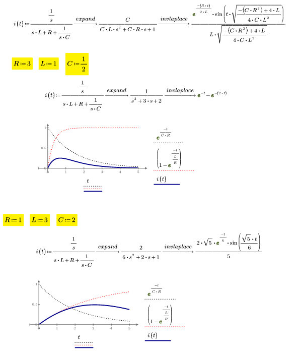

i am currently making a calculation with Mathcad Prime 9.0, where i got 3 different load cases and i want them all in 1  sheet.
i made a few formulas at the beginning, and will later calculate my loadcases with them. For that i wanted some variables to be empty, so that they will just shown as their variable name, so i can later change this variable in every load case to a different number.
  1. When i just use a non defined variable, the whole formula cant used further
  2. When i give the variable a value and change it later, it will not recalculate the formula with the updated variable.
Is there a Solution for this? Or is this just how Mathcad works?

Instead of mere 'formulas', you should use functions.
So instead of
which requires m and a to be numerically defined, before F can be calculated, (hence the red error mark)
use:
Where you can fill in the numbers for m and a once you're ready to calculate the corresponding value of F.
And you can calculate the results for a set of scenarios:
