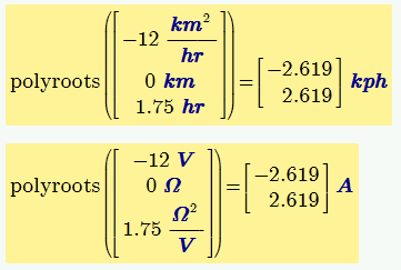

polyroots() is fully unit aware and works intuitiv as expected - you just have to take care and use the correct units all over. And as Prime has dynamic unit checking you also have to supply the correct unit for a zero value.
That was the failure in your sheet. In your first attempt you supplied no unit at all and in your second the wrong unit. The correct unit for the coefficient of the linear element is length. If you supply km (or m, it doesn't matter) you get the correct result.7.png
Even the eror message makes sense (though it wasn't helpful in your case). Mathcad can't tell the desired unit of the resulting variable unless you provide units for the first two elements of the vector. You can provide ANY units for those first two values, but the third (and all following for polynomial of higher order) have to be consistent. So you will never get an error that element 0 or element 1 should have a different dimension.

polyroot(v) will always solve so that the scalar product of v with the vector of powers of x is dimensionless
So you have a couple of choices to get polyroot to work.
The obvious and most natural one is to strip all units
Another approach is to make all elements the very same unit
Both ways above of course will give you a dimensionless solution. If you want solutions with correct units, you will have to adapt the units in the vector accordingly (which does not feel natural on first sight). The rule is to make the second element (the coefficient of the linear element) show the reciproke of the unit you want to see for the result. If the dimensions of the rest are OK this will work. In your case the dimension of the coefficient of the linear element is length (the zero reults from L-L). So we have to divide the whole vector by length and multiply by 1/velocity. Chosing the correct units might be tricky.
