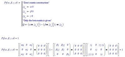

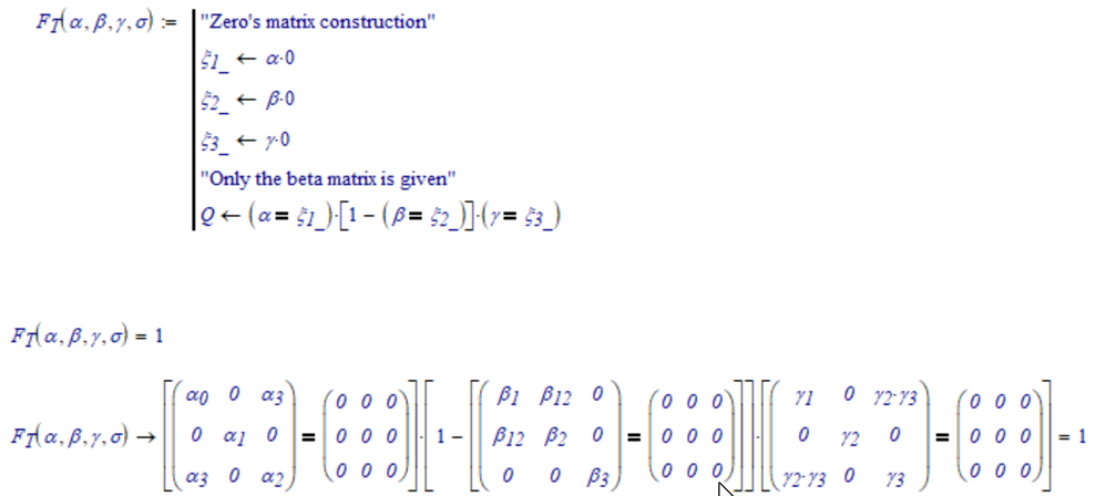

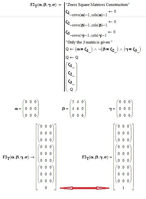

Hello everyone,
why the program, reported below, does not work? There seem to be problems with conditional operators. In fact the program on the right, where no conditional operators appear, gives the required result.
I sincerely thank those who will find the error and all those who will try to solve it.
Attached is the worksheet.

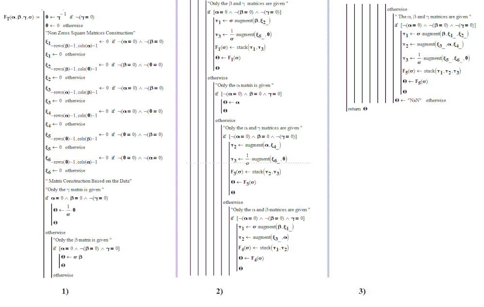

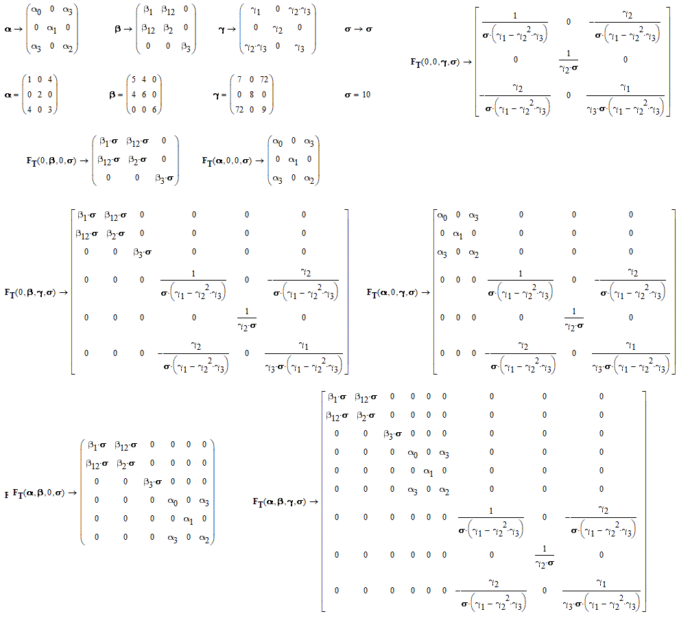

Hello everyone!
I solved the problem this way:

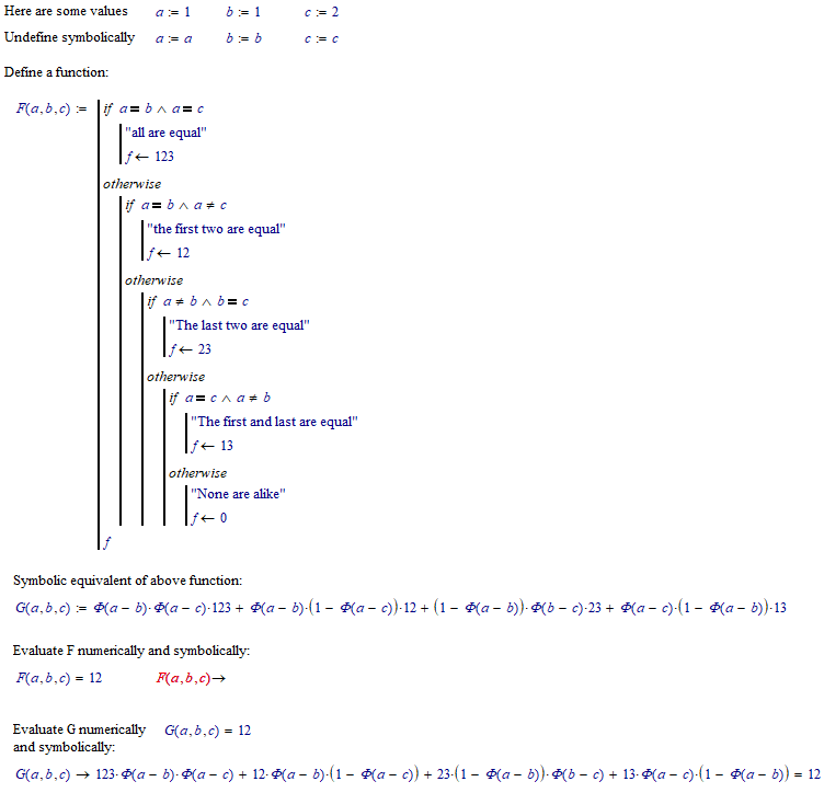

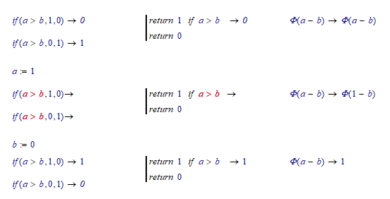

The if() function and the if construct don't always work symbolically. The step function 'Phi()' may be a symbolic alternative:

Incidentally, those simple theta's at the end of many of your if-blocks do not actually do something.
It's the final theta, at the end of the program that produces the result.
If you want your program to produce the result of the first if statement that is TRUE, you can use:
return theta
Where return is the programming construct, from the programming panel...

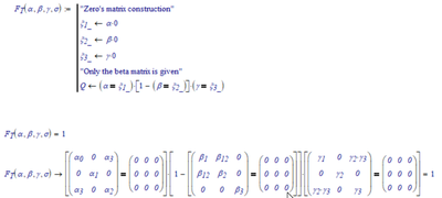

The evaluation of the same logical equation in the comparisons takes on opposite values as seen in the photo, so nothing works.

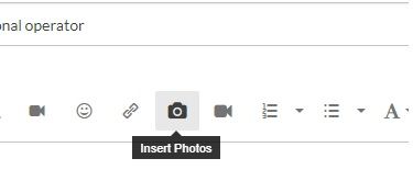

Yes and as I see you experience the same problem as I do: the inserted picture is far too small and of mediocre quality and looks rather bad. Its not inserted using the original dimension and is scaled differently compared to a pic inserted via "Insert Photo". 😞
!! The following is not contributing to this thread and is done for testing purposes only !!
Pic inserted via cut and paste:
Pic inserted using the "Insert Photos" button:
Pic inserted via cut & paste and the stretched to match approximately the size the above pic was automatically scaled to:
It looks like when we manually stretch the pic we get the a similar quality as when inserted via the button. Bad that we have to think about stretching the pic every time we insert one.

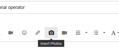

-MFra-
(To:Werner_E)
I wanted to say that I also always use "insert photos" and it is not clear to me why the mentioned problem arises that is of poor quality of the photo.
