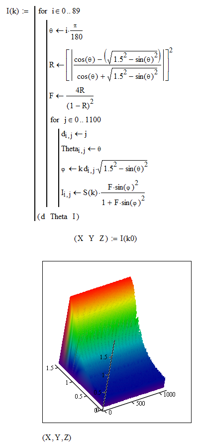

Could anyone help me to sort the output of my attached program so I can plot I(k0) when x-axis is "d" and y-axis is "theta" ?

I assume you want a 3D plot with d on the x-axis, theta on the y-axis, and I(k0) on the z-axis:
As others have noted, move stuff out of the inner loop that does not need to be there. You also don't need to create large vectors or matrices of intermediate results that you do not return from the program.

Another approach is to use a 3D plot.
Stuart
PS: As FM has indicated, you can improve the efficiency of your programs by moving expressions out of loops where the expressions don't depend on the loop variable.   If you don't intend to vary d, you could just replace it by j.
August 11, 2016
Additional remark: In case you'd like to see theta in degrees rather than radians, you may change the last line in the program to read "Theta/deg" instead of "Theta".

Mmm... I get this other plot.
Alvaro.
August 11, 2016
When you call "CreateMesh" theta runs from 0 to 89, but those values are interpreted as radiants in your function, not as degrees as it should be. Try to let theta run from 0 to pi/2 and you should come closer to the plots we have seen in the posts before.

I really appreciate all of you for your valuable suggestions. For the last step, I need to export the data to Sigmaplot. I was not able to do this step from the output of the suggested method, so I modified the program. The new data set generrates different contour plot in Mathcad , but when I transfer them to Sigmaplot, the same contour plot can be obtained as you obtained here. Am I doing a mistake here?
Thank you.
August 12, 2016
In your last attempt you just create 3 vectors with the x-, y- and z-values of a bunch of points. Mathcad can't create a surface if it is just given a number of points - it does not know how to connect them - it would need a mesh.
But Mathcad can plot each point. Just change from contour plot to "scatter plot" and format the point size and color. I am not sure why, but the plot looks much better if I set a samll amount (1% is all it needs) of transparency.
