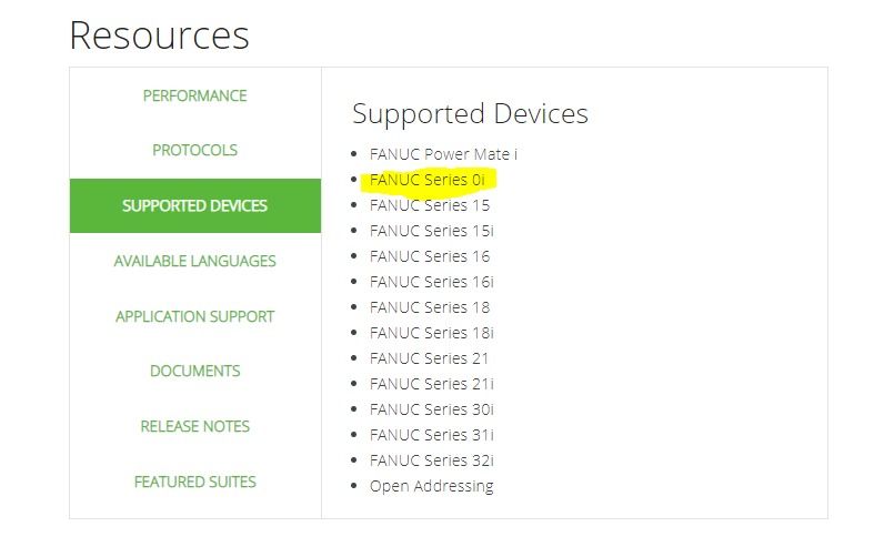

But we can´t see the SERIES 0i in the devices list, SERIES 0i doesn´t appear on the list
What are we doing wrong?

Best answer by bmacri
Greetings Matías,
I'm sorry for the confusion.  Choose the "Open" selection in the model dropdown.  That selection is for all the other models that are not listed.  With so many different models being added, it became a maintenance nightmare to try and list them all. The "Open" selection is what you need to move forward with your project.
Thanks!
-Ben
bmacri12-AmethystAnswer

June 2, 2021
Thank you!!!!
We tried using Open Model, but when something doesn't work, anything can be the culprit
