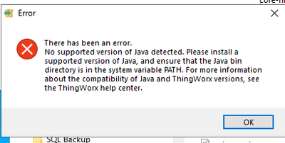

I have problem with Java SDK version.
Release matrix has information about Java SDK. It should be: Oracle JDK 11.0.12
I download it from this page:
Java Archive Downloads - Java SE 11 | Oracle Polska
I installed it and when I tried install TWX 9.3.7 I had this error:
My Java_Path variable looks like this.
What kind of Java SDK is support?
Oracle JDK 11.0.12 is fine. Below is ThingWorx Foundation 9.3.7.0 Release Matrix
https://release-advisor.ptc.com/releaseMatrix?releaseId=1350
You should set folder path of <jdk-11.0.12> to JAVA_HOME, do not include bin folder in the path.
