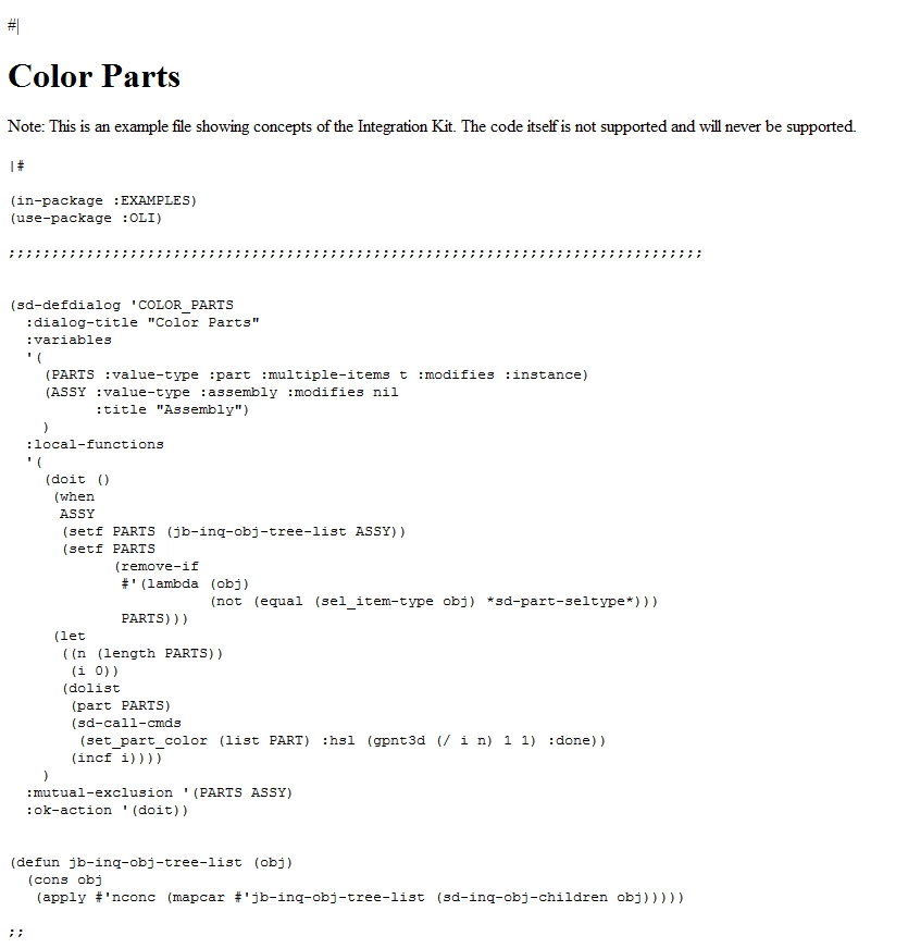

Usually drag the LISP file to the modeling work area,then the function command show in the toolbox.
But it show none in the toolbox when you do it in CEDM 19.0.
I take the example  "Color Parts"  in the integration kit,and save as a LISP file to dray to the modeling work area. It's still failure.

New starting in 18
you have only to ad the line ":toolbox-button t" in your Lisp
:toolbox-button t

New starting in 18
:toolbox-button t

Yes,it's work as your suggestion.
