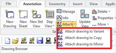

what are the differences between To True Copy and To Variant?
Haydena
Excuse me, sir
Creo Elements/Direct has the options of Attach drawing
Could you tell me when I can use Variant and Copy?
What are the differences between to true copy and to variant?
If I use "variant" to replace "copy", am I wrong?
Or will have some influence?
You can use True copy
If you copy a part, after creating a drawing for that part, and the you keep the view sets in the new part.
To Variant,
If the part is copied before making a drawing of it you can use copy to variant to copy the view sets to the new part.
To be honest, I rarely use true copy. Copy to variant will check for valid view sets first.
To Variant,
