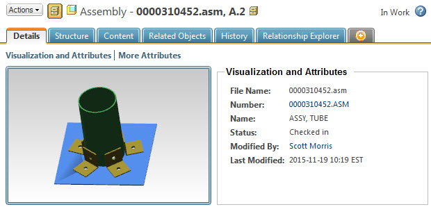

The default tabs for a CAD file are shown below.

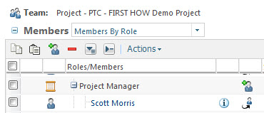

To create a new tab, you must be a member of the Project Manager role in your team's Windchill project.

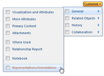

To add content to the tab, use the Customize button to add the Representations/Annotations panel.

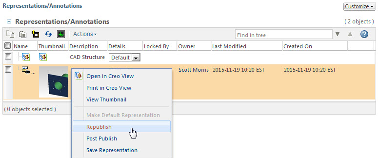

The Representations/Annotations panel will look like this, but include information for the CAD file you are looking at.
If for some reason your Creo View published representation is missing or out of date, you can use the Republish option to create a new one.
Note: The new tab will only be visible to the user creating the tab. New tabs cannot be shared with all team members, they can only be shared with the entire system and that action is limited to Windchill System Administrators only. If this is considered valuable for all users, I can certainly add it to the configuration so all users have access to this information.

Hello Scott,
Thanks for the nice guide. Three questions came to my mind after reading it:
- As you mentioned in the lower note, how can I add the tab to the configuration so that all users can have it? to us it would be very useful especially for non-CAD authors.
- Is it possible to set up Windchill in order to automatically make, in addition to the republish, also a "save representation" action when I do a custom check-in? It woud be very useful for having the .pfd files automatically stored on windchill;
- with the post-publish, a second publishment is made in addition to the already-present one?
thanks
Bye
sm_011-VisitorAuthor
November 25, 2015
Ah, I assumed you were asking this question about the PTC Academic Windchill server which is what all the FIRST teams use and the location of this discussion. I did not realize this was a general Windchill question.
  1. If you are a Windchill Admin, you can make the tab visible to all.
  2. Windchill should republish your CAD and Documents on each check in for you.
  3. If you republish, the new representation becomes the active representation for the current iteration.
You can get more information about Windchill Publishing in the About Visualization section of the Windchill Help Center which is under under the Specialized Administration, Supporting Visualization and Publishing topics.
