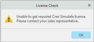

This message appears every time I try to open a parametric file in CREO 6.0 simulate. My classmates have been able to use simulate with their licenses, am I doing something wrong?
In case you need access to Creo Simulate, you can use the university campus license or purchase Creo Student Premium from the eStore (store.ptc.com).

Creo Student license file does not contain CREO Simulate license. Please read https://community.ptc.com/t5/PTC-Education-Forum/Creo-5-0-Simulate-for-Student-Version/td-p/587984 discussion.
Martin Hanák
