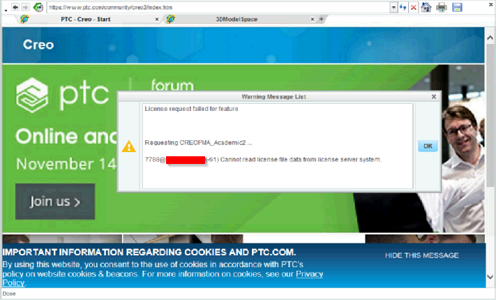

We are currently running the old version 2 of CREO Academic and just recently we are receiving the error, License request failed for feature
Could someone advise how we resolve the licensing request.

Thanks for the information however, the firewall on the license server is turned off so communication is not being blocked.
Where is the license file held and does this need updating annually?
Seems everything was just fine and I am wondering if the license has expired, even though I believe the product is free for educational use.
