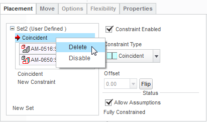

If you chose "Edit Definition" from the model tree or RMB for the given component, you can activate the "Placement" tab in the ribbon to show all the constraints and their status. You can update or remove individual constraints or the whole constraint set.

You should be able to pick Edit Definition from the Right Mouse Button (RMB) meun in the model tree or on the component itself. Make sure the window you are looking at is the active window (Ctrl-A) and you are not actively placing a component or making/changing a feature. This option is only available when the current operation has been completed.
