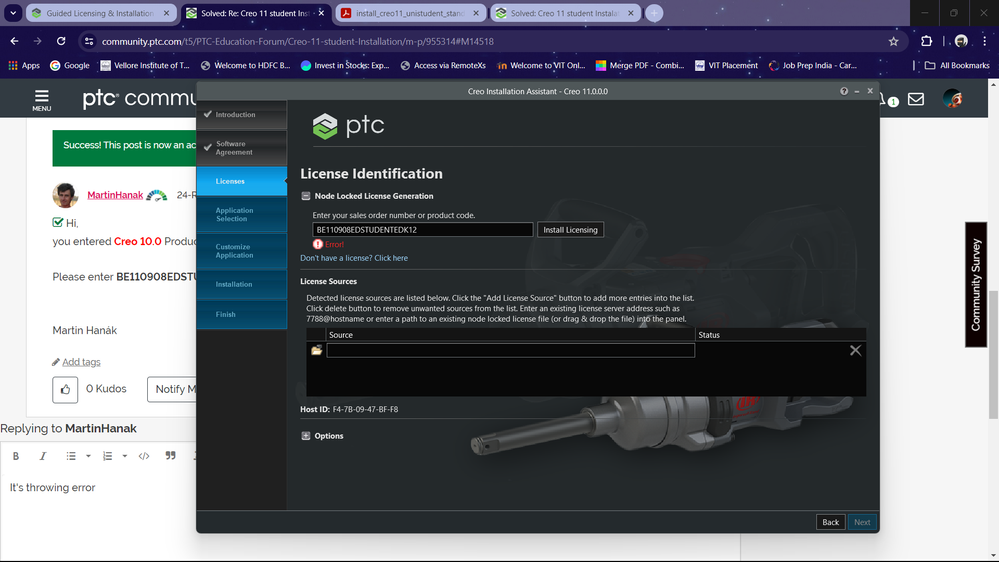

@SD_11123179 wrote:
option no.1
In File Explorer go to C:\ProgramData\PTC\Licensing directory. If it contains some files them move them to different directory.
C:\ProgramData\PTC\Licensing directory must be empty before you launch setup.exe.
Launch setup.exe.
option no.2
You can request license file via email. Please read https://community.ptc.com/t5/PTC-Education-Forum/Creo-Parametric-9-0-Student-Edition-Licence-error/m-p/897846 discussion.
Martin Hanák
BK110908EDSTUDENTEDUNI, I tried with this code, after installation I am getting errorScreenshot (244).png
@Alex_Cazacu told me that for Creo 11.0 students should use Product code BE110908EDSTUDENTEDK12, only.
Product code BK110908EDSTUDENTEDUNI causes error you reported, therefore it should not be used.
