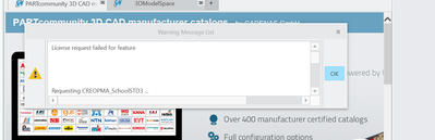

I installed Creo 6.0.2.0.  I keep getting this error message and shuts off when I click OK.  There was never an older version of Creo installed in this computer.

did you follow procedure described in https://apps.ptc.com/schools/references/install_creo6_schools_standard.pdf -OR- https://apps.ptc.com/schools/references/install_creo6_unistudent_standard.pdf ?
What Product code did you enter during installation ?

During Creo installation you have to follow 2 basic rules:
  • hidden directory C:\ProgramData\PTC\Licensing must be empty
  • one of following Product codes must be used
               K-12 students can use Product code BE600908EDSTUDENTEDK12
               University students can use Product code BK600908EDSTUDENTEDUNI

That is my question. If it is installed in this computer for the first time and there is a license, why is it giving me an error message?
I now have it installed and all ok with no error message on starting up Creo, is there something else I am missing here?
What is the error message stating? Please expand the window and tell me what it is the full message so I can understand what is wrong.

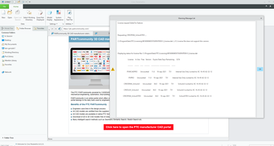

[cid:f46066b2-38bf-406a-b9e7-f6ee9138b022]
When I click OK it shuts down
Can you expand the message window so I can read all the text and post here a picture?

The license you installed is for Creo 5.0 and not for Creo 6.0.
You need to run setup.exe and use the correct product code for Creo 6.0:
