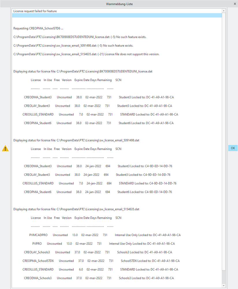

After looking at many questions and solutions posted here, I finally give up.
The license I requested does not seem to work properly with my Creo version.Screenshot 2021-03-01 130000.png I have tried the key I am supposed to use, two others from the forum, the license files from my email are also added.
What else can I do?
This is the second machine I am trying this install. On the other it worked fine - is there a way to port the license in case it is restricted to one machine?
Thanks in advance,
Moritz

@MB_9792676 wrote:
I have attached the ip.txt below.
C:\ProgramData\PTC\Licensing\sw_license_email_5091498.dat
  • license is generated for different computer
  • you cannot use this license file
C:\ProgramData\PTC\Licensing\sw_license_email_5154635.dat
  • license is generated for your computer
  • license contains Creo Parametric 6.0 license (CREOPMA_SchoolSTD6, version 37.0)
C:\ProgramData\PTC\Licensing\BK700908EDSTUDENTEDUNI_license.dat
  • license contains Creo Parametric 7.0 license (CREOPMA_Student6, version 38.0)
  • you CAN use this license file
1.] open parametric.psf file in Notepad (it is located in Parametic\bin subdirectory in Creo installation)
2.] check/modify two following lines
ENV=PTC_D_LICENSE_FILE-=C:\ProgramData\PTC\Licensing\BK700908EDSTUDENTEDUNI_license.dat
ENV=CREOPMA_FEATURE_NAME=CREOPMA_Student6 ()
3.] run Creo
What else can I do?
Thanks in advance,
Moritz
please run following command in Command prompt window on problematic computer and upload ip.txt file.
ipconfig /all > ip.txt
March 2, 2021
3.] run Creo

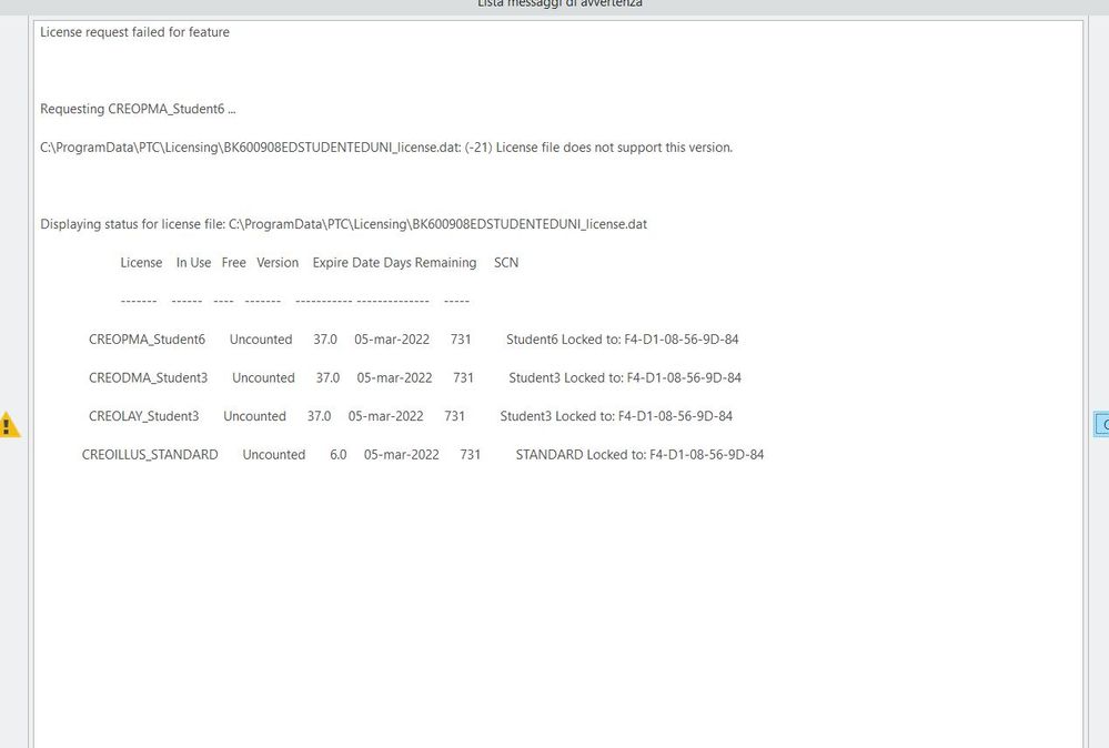

Hello, I have the same problem, when I open creo I read the same message that I attach.
I've read and tried the solution that you suggest but I don't know what is the file named ip.txt.
Could you help me?
Could you help me?
license file mentioned on the picture contains Creo 6.0 license. Unfortunatelly you are using it to launch Creo 7.0.
