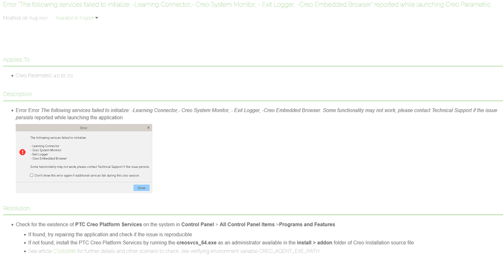

After installed Creo 7.0 Student version, when i start the programme I got this message:
"The following services failed to initialize:
- Learning Connector
- Creo System Monitor
- Exit Logger
- Creo Embdedded Browser
What can I to do?

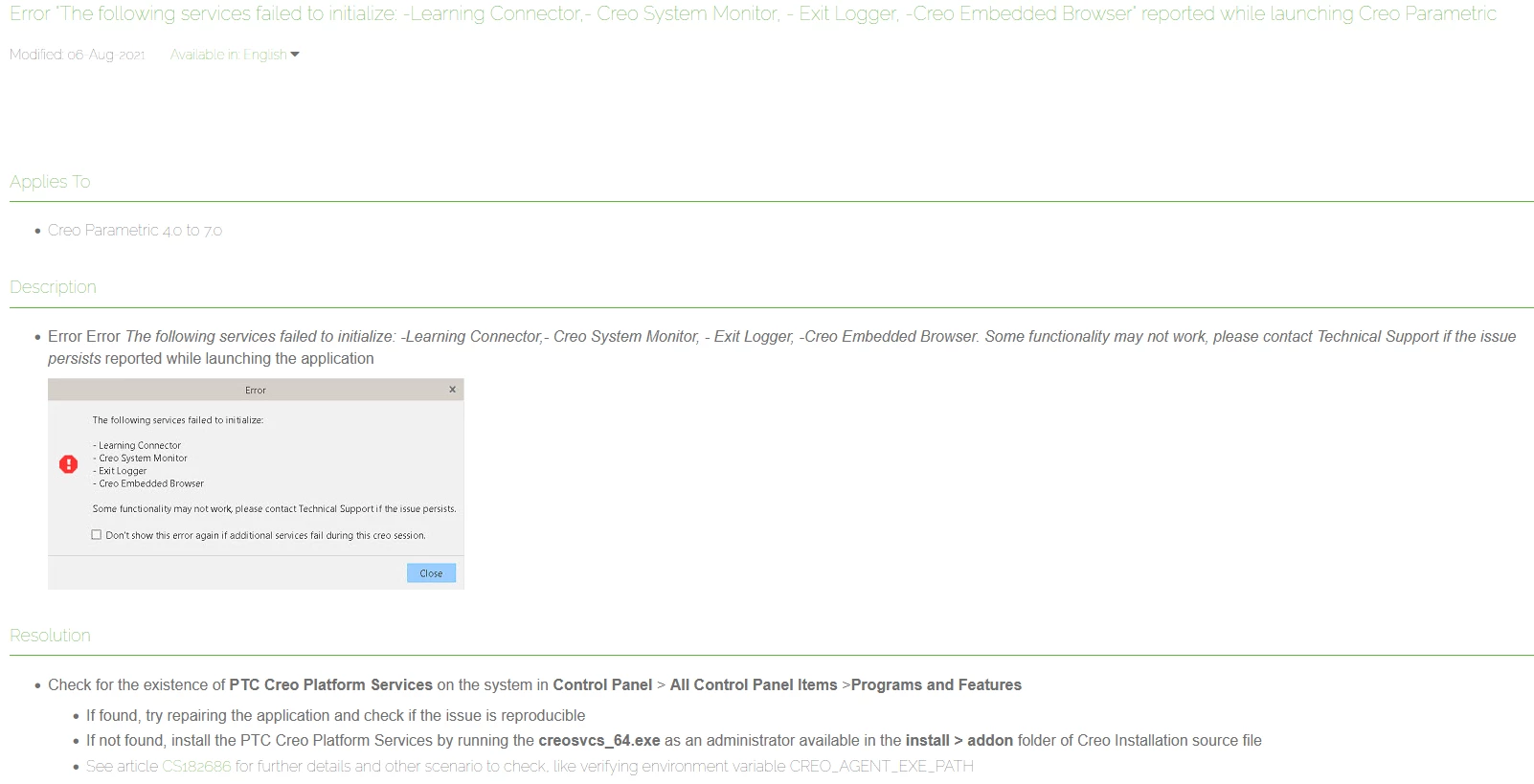

September 18, 2021
Read this article - "Error "The following services failed to initialize: -Learning Connector,- Creo System Monitor, - Exit Logger, -Creo Embedded Browser" reported while launching Creo Parametric": https://www.ptc.com/en/support/article/CS331638
