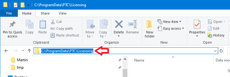

did you remove expired license file from C:\ProgramData\PTC\Licensing directory?

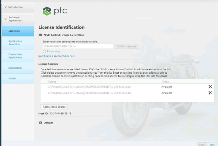

I didn't have the file "Licensing", but I remove the Creo 6.0 file. Now I can see these file (pic). But when I try install file i can still see the previous files in "license sources" (pic)
I tried also that I create a new email user, but it didn't work also. I tried other computer, and still didn't work.
you have to remove expired license files from C:\ProgramData\PTC\Licensing directory. To access this directory you have to copy&paste C:\ProgramData\PTC\Licensing path into address field of File Explorer (as shown in following picture) and press ENTER.
