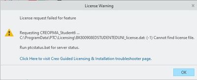

Error with student licence
i get the error below
why is it looking for the version 8 license?
I used BK900908EDSTUDENTEDUNI_license.dat for the installation and this license file is where it's supposed to be
pls help, anyone - thanks
you have to modify parametric.psf file located in Parametric\bin subdirectory in Creo installation.
  • open the file on Notepad
  • locate the line starting with ENV=PTC_D_LICENSE_FILE-=
  • correct path to license file
  • save the file
  • run Creo
