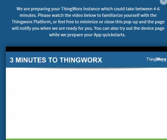

I'm an student and i'm new with this environment, i wanna learn about Thingworx but i dont know what should i do to obtain an access or an instance to start, can someone help me please?

Hi Cristian,
You obtain an instance when you follow any of the application Quick Start kits from this page.
After you pick one of the Application Quick Start kits you will be brought to the developer portal. Click on Go to App Tutorials and you will see the popup below
Once the instance is ready you will receive a link that will send you to the applications page. Here choose once again the application that you want to follow and click start. Here you will be able to access your automatically generated ThingWorx instance.
You can use this instance to develop the tutorials from the academic program as well. Nevertheless note that the content on this instance will be available only for a month, after which the instance will be automatically deleted and you will need to register again to receive access to a new ThingWorx instance.
