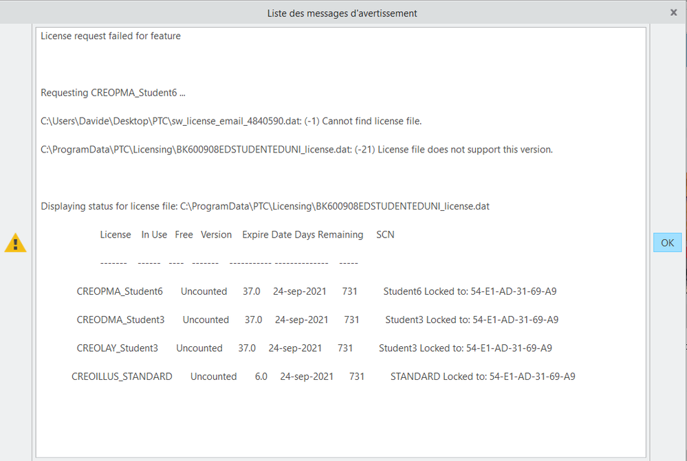

I've just installed the sudent version 7.0 but I have a litle problem... I cannot start CREO parametric due to the folowing window message.
Could you please help me?
Thanks in advance
Morais

your license file BK600908EDSTUDENTEDUNI_license.dat contains Creo 6.0 license. Please read carefully documents mentioned in https://community.ptc.com/t5/PTC-Academic-Program-Discussions/product-code-or-sales-order-number/td-p/684922 discussion.
Thank you very much for your answer!
It was the code indeed! 🙂
Unfortunately I've installed de 7.0 student version with the installation guide of the 6th version 🙂 that's why I had the problem. I reinstalled with the right guide and It is all good now!
