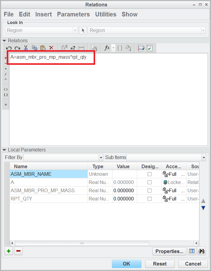

I finally understood your question ...
CS43832 contains following advice:
In order to use Relation in Repeat Region to get the total mass of an assembly component, Do following steps:
1.]
Define report parameter in repeat region by selecting the table cell > click right mouse key > Report Parameter > select rpt... > select rel... > select User Defined > enter symbol text (such as A)
2.]
Table > Repeat Region... > Relations > select the repeat region > enter relation as below
A=asm_mbr_pro_mp_mass*rpt_qty
Also expand Local Parameters list and check whether ASM_MBR_PRO_MP_MASS parameter exists (Type=Unknown). If parameter is missing you have to create it (set any Type, Creo changes it to Unknown)
3.]
Click Update Tables > Done
Martin Hanák

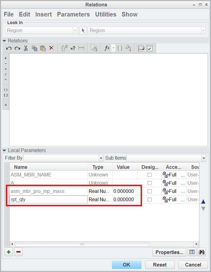

Hi Martin,
where do I have to create the asm_mbr_pro_mp_mass parameter? And do I have to assign a value to it? When I create it in the part, it has no effect (see attachment. I can't create it under "reported mass properties" as the plus is greyed out there). When entering the relation in the repeat region, I get an error message that asm_mbr_pro_mp_mass is an invalid symbol.
Greetings

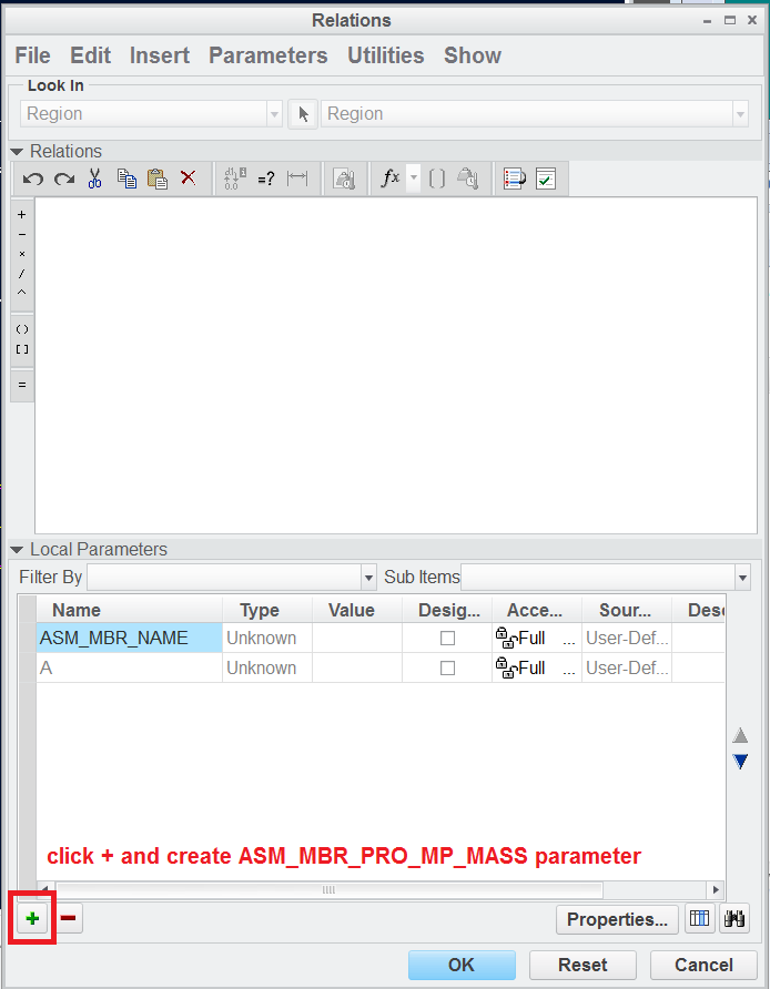

MartinHanak
(To:Ramax)
@Ramax wrote:
Hi Martin,
Greetings
I am sending a couple of pictures.
pic1 ... my repeat region containg rpt.rel.A
Table > Repeat Region... > Relations > select the repeat region opens following dialog box
I had to create both parameters
when parameters are available, you can add relation
result is above
Martin Hanák
Ramax
(To:MartinHanak)
Ah the parameter box is right beneath the relations. That does the job.
Thanks a lot. I really owe you a beer or something^^.
