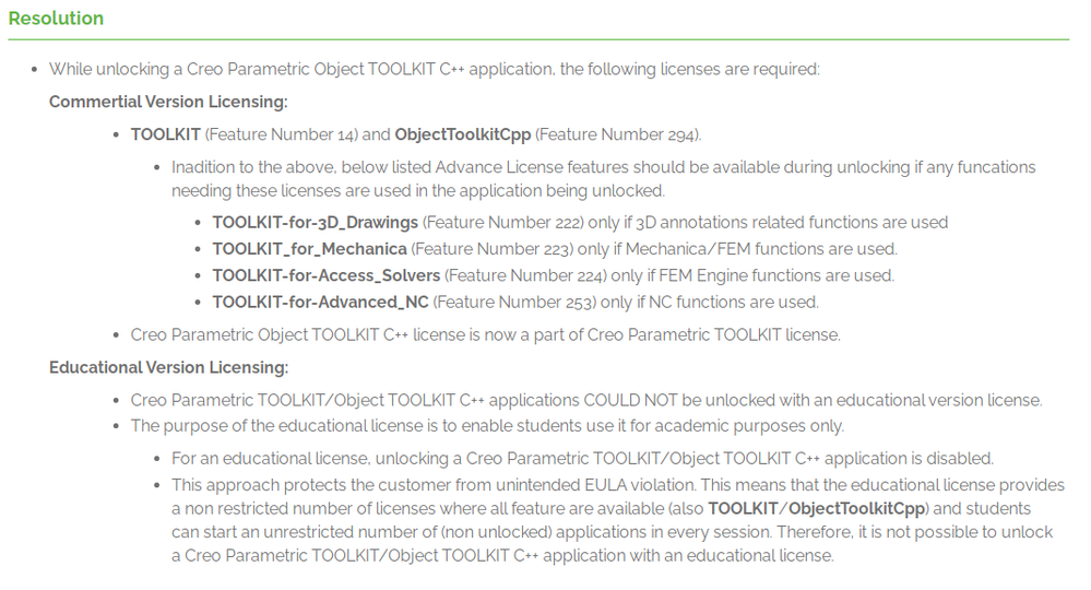

Hello. the educational license provides a non restricted number of licenses where all feature are available (also TOOLKIT/ObjectToolkitCpp) .but  Creo Parametric TOOLKIT/Object TOOLKIT C++ applications COULD NOT be unlocked with an educational version license.can educational version license uses Creo Parametric TOOLKIT/Object TOOLKIT C++ applications?
3 REPLIES 3
Read this article - "Information on Licenses needed for unlocking a Creo Parametric Object TOOLKIT C++ application": https://www.ptc.com/en/support/article/CS125183
And another one - "Unlocking a Creo Parametric Object TOOLKIT C++ application requires TOOLKIT-for-3D_Drawings license even though no API with additional license requirements are used": https://www.ptc.com/ru/support/article/cs256747

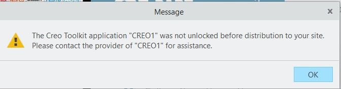

Is the educational license can not install auxiliary application ?
Is there any other way to run auxiliary applications in the educational license?
