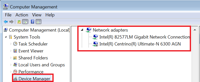

1.] open Computer Management window and check physical network card's status. All your network cards must be enabled.
On my PC, 1st card (Ethernet, wired) is enabled, 2nd card (WiFi) is disabled (see small down-arrow in circle)
2.] open Command prompt as Administrator and run following commands
netsh interface ipv4 set global dhcpmediasense=disabled
netsh interface ipv6 set global dhcpmediasense=disabled
3.] restart PC
4.] run ipconfig /all > ip.txt command, again check its contents (also you can upload the file, I can check its contents, too).
