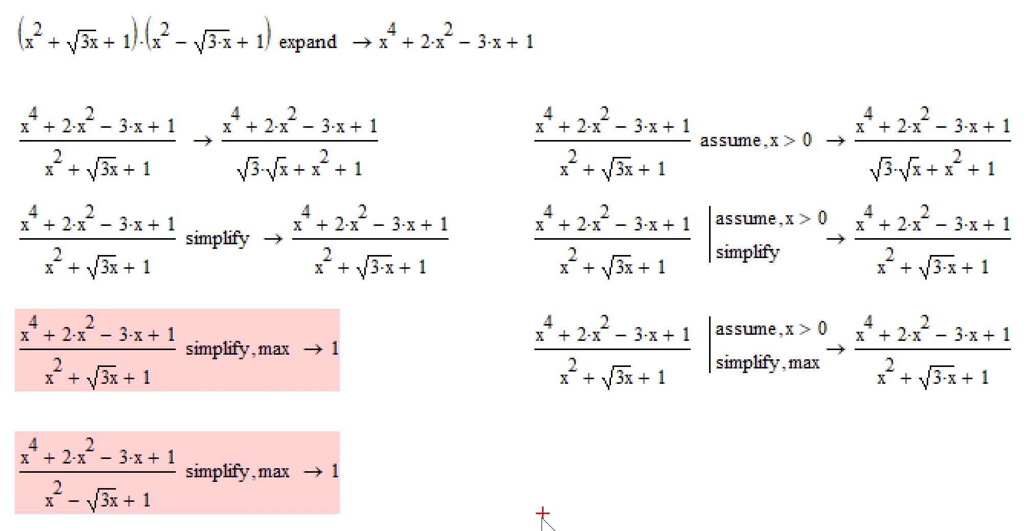

We all know that the symbolic engine in Mathcad (mupad) is not state of the art and often is not capable to solve or simplify expression where other software succeeds.
But this wrong result "1" is surprising nonetheless.
Can anybody provide an explanation (other than it being a bug)?

Every software has its bugs as nobody and nothing is perfect.
Noentheless I consider this bug as a liitle bit special as the calcultion in question is rather simple and straightforward and the wrong result is surprising.

April 1, 2018
While playing around with those expression I also noticed that "assume,x=real" for some reasons unknown to me will force the symbolics to return a correct simplified result.
Its funny that "assume, x<0" also has the same effect, but x<=0, x>0 or x>=0 not!
Furthermore you'll notice the different ways sqrt(3x) is "simplified"
Nevertheless  a blatant error like the result 1 given never should occur - thats a severe bug.
