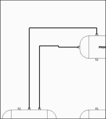

I am unable to change the width of a fiber shape. No matter what value of "width" I put in for shape properties of that fiber, the width remains the same on the diagram.
Any help would be appreciated!
Example: One of the fibers here has a width of "10" and the other had a width of "1" but it does not change the appearance

Hi ,
while it is some how confusing , Width and Pitch setting for fibers as applicable only for decorative line type (i,e: Scroll, Triangles and so on) ;
for plain lines (i.e Solid, Dashed long/Short and so on) you can select from the line type 3 pre-defined thiknesses : Thin/Medium/Thick (i,e, Solid Thin , Solid Medium and Solid Thick.)

Solved!  Thank you, I appreciate your response, that was not intuitive. I am using the Thick_Center line to achieve custom thicknesses on a simple line font.
