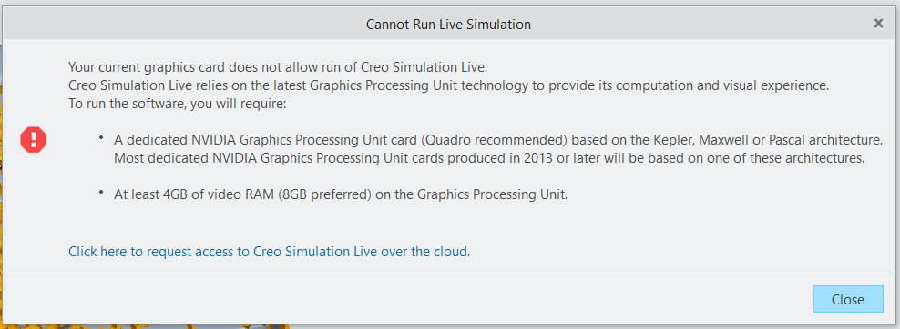

Cannot Run Creo Simulate even though I have ok Graphics Card
  • December 3, 2019
  • 3 replies
  • 2167 views
See error below. Says I don't have adequate graphics, but I have an M1200 with 4GB Video Memory.

Is it an approved graphics card?
kkantebe1-VisitorAuthor
December 3, 2019
It should be.
NVIDIA Quadro M1200
Dale_Rosema
December 3, 2019
Is this what you already tried?
https://www.ptc.com/en/creo-hardware-check
December 4, 2019
I think the only action you can do is graphic card driver update to current version.
22-Sapphire I
December 4, 2019
@kkantebe
Simulation Live needs a CUDA-Enabled NVIDIA card..
Check details in article CS302825
