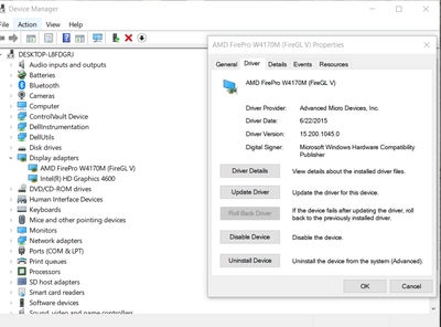

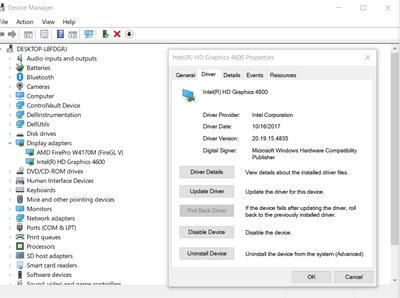

please provide more details about your graphic card. See following picture as an example how to do it.

josh_g
(To:MartinHanak)
MartinHanak
(To:josh_g)
I would say that your laptop is already of an older date. Therefore you can expect problems when you install newer Creo release.
The following tips are without guarantee !!! Before you start your experiments, please ensure that you are able to install current driver versions.
Check manufacturer web and look for newer drivers for both cards. If you can't find anything, you can try the following:
Intel HD Graphics 4600
https://www.intel.com/content/www/us/en/download/18369/intel-graphics-driver-for-windows-15-40.html
Driver Version: 20.19.15.5171
Build Date: Nov 4, 2020
AMD FirePro W4170M
https://www.amd.com/en/support/kb/release-notes/rn-pro-win-19-q3
Article Number RN-PRO-WIN-19-Q3
Last Updated: August 7, 2019
