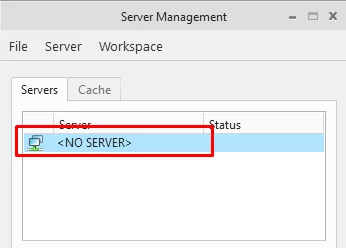

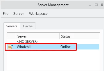

Utilizing the same configuration files and settings: If I start Creo without the trail file being automatically run and run it manually it works perfectly.
Server Management - Without Trail File Ran Automatically
If I start Creo with the same trail file being run automatically the saved server is no longer shown. The trail file seems to run correctly as the second blank tab is opened successfully.
Server Management - With Trail File Ran Automatically
Not sure what is causing this.
Trail file is very simple as it just opens a second blank tab currently.

The shortcut target is set to the following:
"C:\<INSTALL_PATH>\Parametric\bin\parametric.exe" "C:\<INSTALL_PATH>\StartupTrail.txt"
Thoughts on what is causing this
Best answer by Van_AG
You have automatically started the trail and there is only <No Server> in the "Server Management" window.
After that, just register (add) your wt-server manually again in the "Server Management".
Then restart Creo with your trail file.
Server registration will be kept.
May 27, 2024
The trail breaks wt-authentification process.
You should start with the trail and register the server again.
It will force Creo to remember server status.
And then restart with the trail.
