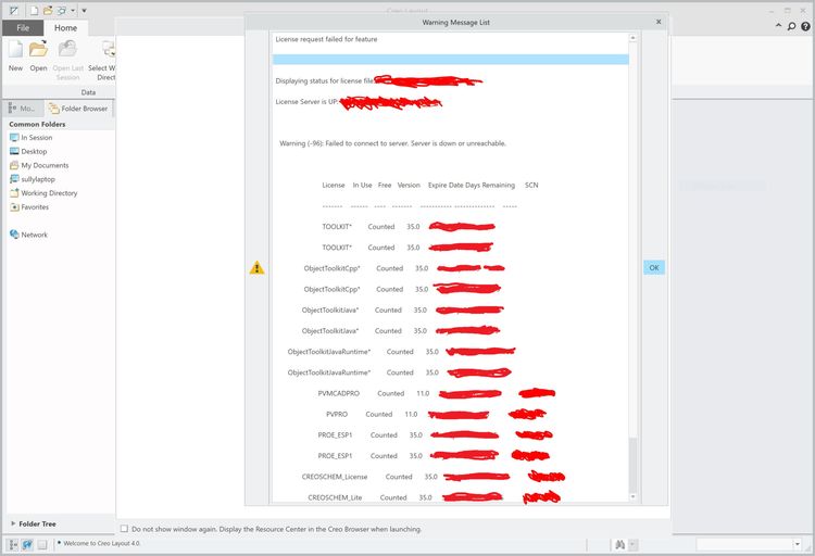

I did a little more digging... and if I load up Creo Layout (something that we DO NOT have a license for)... it actually gives me MUCH more information:license_redacted.JPG
This is really interesting because it is showing that the "License Server is UP". Similarly, it is actually returning the licenses I DO have... so I know that it's actually getting a response from the license server. Any ideas?

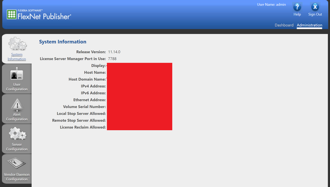

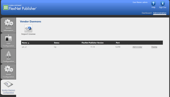

For all of our previous versions of Creo (2, 3, 4 M010, 4 M020)... we had been pointing our license file to the Port used by the License server (7788), NOT by the "ptc_d" daemon itself (in our case, something random like 55298).
So my license file for Creo 3, Creo 4 M010, and everything else could be
ENV=PTC_D_LICENSE_FILE-=7788@<XXXXXXXXXX>
But now, in Creo 4 M030 and M040, we have to point directly at the "ptc_d" daemon. Untitled.png
So our ".psf" file has to say:
ENV=PTC_D_LICENSE_FILE-=52298@<XXXXXXXXXX>
Is this what you are doing today also? I'm curious because all the PTC documentation that I have seen so far has pointed us towards using the IP of the server itself, and it seems like it should be something we should be able to do.
