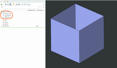

I am using Creo Parametric Release 9.0 and Datecode9.0.2.0
When I select a quilt in the model and hide it, the Model Tree does not update accordingly anymore*. As a consequence, it is not possible to show the quilt again by acting on the Model Tree.
* In Creo 7 it all worked fine.

The layering scheme can be a cause of this behavior. Confirm that the quilt in question is not on a layer. If it is on a layer, show the layer and or remove the quilt from the layer and then test show/hide for the quilt. If this does not solve the issue, post your model or a test model.

This seems very interesting, I tried to replicate the example and my problem seems to be I cannot see the section Quilts under Design Items.
How do I activate this feature?
