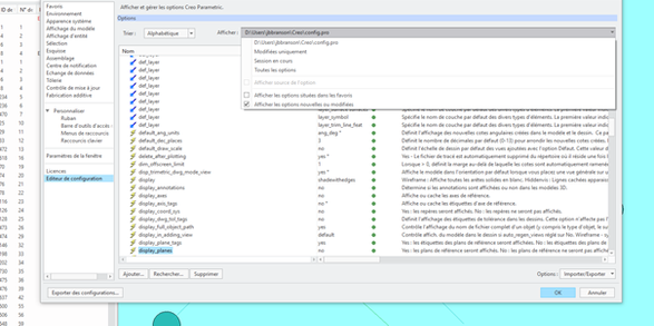

Hello all.
I'm trying to have my own environnement in Creo .... (I hate the dark font color !)
I know, it simple, you need to register it and save the syscol in your config.pro. Problem is that my company don't allow it : every time i start Creo, it suppress the old config.pro and replace it by the standart one.
So I try to creat a batch who execute my company batch and then replace the syscol.scl. To do it, i created a trail who made that task
Unfortunatly, each time i start by batch, he never execute my trail. What i'm doing wrong ? Maybe there is a simpliest way to do it ?

Ho my bad. I did'nt explain my program :
H:\proc_sh\cae\start_creo5.bat is my firm batch. This is where the config.pro is automaticly replace
P:\Couleur.txa is my trail. I know this one work. I use it when I open creo but i have to go start him.

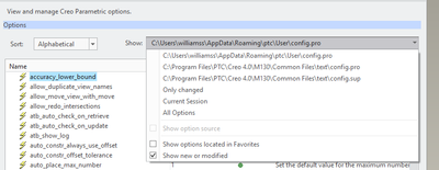

Go to FILE - OPTIONS - CONFIGURATION EDITOR.
At the top, in the box labeled SHOW:, click the down arrow. This lists the config files you are using.
You can have MORE THAN ONE config file.
My system loads our company standard config.sup file (these are the "unchange-able" options)
It then loads the company standard config.pro file (these are the options the company wants me to start with but are changeable)
It then loads my config.pro file which is my personal settings that make creo run the way I want. For example, this is where my syscol file is called for, also where my mapkeys are and others I want to use.
This is why I asked "where is the config.pro files". There is NOT just ONE config file.
