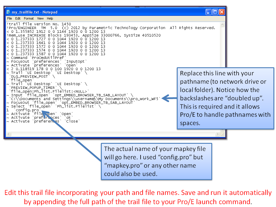

Okay... here's the definitive answer I promised using the trail file technique. I have verified that this technique works and will consistently enforce your standard mapkeys EVEN when the user attempts to overwrite them.
1) Save your company mapkeys to a standalone file. Your current config.sup file (the one you originally posted for us) will do just fine. However, you should rename it to use the ".pro" suffix. You can call it config.pro, mapkeys.pro, or what-ever-you-want.pro.
2) Place your mapkeys file somewhere everyone can read it... but no one can modify it (except an admin or trusted user). You can make this a network drive or a local folder locked down so users can't modify the contents. This prevents users from messing with your mapkeys.
3) Start a fresh session of Creo Elements/Pro (Wildfire 5). Know in advance where your trail files are written. Once the session starts, do nothing except the following:
4) Modify your Pro/ENGINEER startup command by appending the full path name of the trailfile from step 3. Most people launch Pro/E from the proe.exe command. If your trail file was called my_trailfile.txt and it was located on a mapped network drive (for instance the "M" drive), the modified launch command might look similar to this:
proe.exe M:\company_standards\configs\my_trailfile.txt
5) Relaunch Creo Elements/Pro and test. When the application launches, it should immediately run the trail file you specified. If you're running Windchill or Pro/INTRALINK 9.x+ you'll have to log in to your server before the trail file will run... but this is normal. If you're paying attention carefully, you'll see the options menu pop open and load the mapkey file.
If any user has already set ANY of the mapkeys in your company-wide mapkey file, they will be overwritten thus enforcing your company standards.
Of course, an industrious user could always make a mapkey that would RELOAD their own custom mapkey file AFTER the trail file runs... thus overwriting yours. But at some point the user has to take responsibility if they're going to go to such lengths to circumvent your standards.
This should completely resolve your problem. The toughest parts are editing the trail file and removing the useless parts without destroying the necessary commands. I've attached my own trail file to show you what it should look like.
A brief explaination of the trail file is below... click the image for a larger, more readable version.
I hope this helps! if you get stuck, write back!!
Thanks!
-Brian
