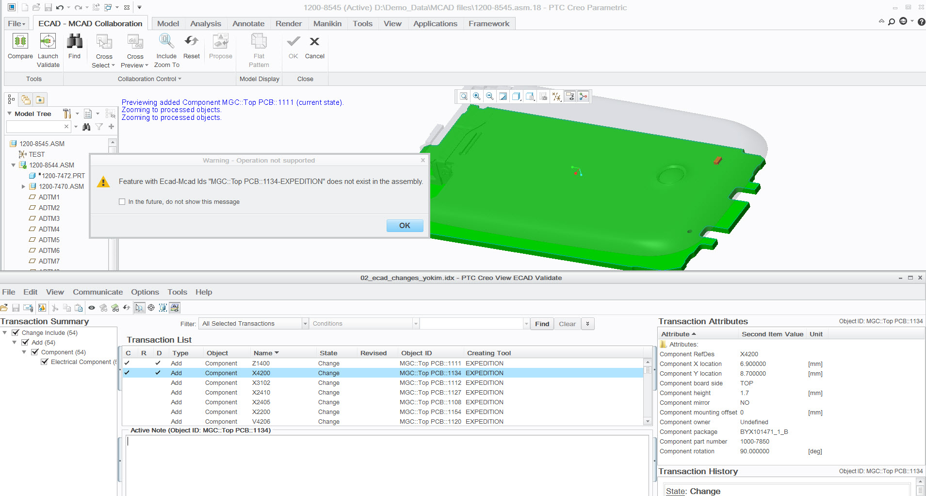

Hello everyone,
Working on the ECAD-MCAD collaboration with IDX-File.
Use Creo3.0 for the MCAD department and PADSVX(Mentór Graphics) for the ECAD.
There some problems when I import IDX-File
"Feature with Ecad-Mcad Ids "MGC::Top PCB:: 1134-EXPEDITION"does not exist in the assembly"
I set right setting for config.pro
      • ecad_mapping_file = location of the ecad_hint.map file
      • search_path = location of the MCAD data
Would be glad if someone faced same problem or see the solution.
Thanks for the help anyway !

I guess there is not any ECAD Designer in PTC. Nobody has not replied this question yet.
I'm not surprised.
llie
(To:agoksu-2)
Are you trying to bring in an .emn and .emp file? If so there is an issue with Creo reading those files. We discovered a workaround.
