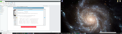

I have been able to download and run Creo 3.0 and 4.0 without a problem, but when I try to download and boot creo 6.0 a message pops up saying "license request failed for feature" I attached a screenshot of what I see on bootup:
any tips?
you have to empty C:\ProgramData\PTC\Licensing directory before starting Creo 6.0 installation !
Please read following documents:
https://apps.ptc.com/schools/references/install_creo6_unistudent_standard.pdf
https://apps.ptc.com/schools/references/install_creo6_schools_standard.pdf
I have the same problem as described above, eventhough i deleted the license i used before from "C:\ProgramData\PTC\Licensing".
Now in the folder there is only one license, with the right date and everything but it still doesnt work.
