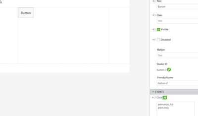

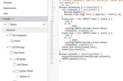

In this code, opacity of "menu" widget, which is a 3D model of a panel with buttons, labels etc. is changed from 1 to 0 and from 0 to 1 in 1600 ms. During this time, all the widgets on a "menu" are rearranged. You have to connect animation_1 and animate functions to some button "click" event.
var start_1 = { a: 1};
$scope.animation_1 = function() {
var onUpdate_1 = function() {
$scope.$apply();
$scope.view.wdg['menu'].opacity = start_1.a;
tween_one = new TWEEN.Tween ( start_1 )
.to( { a: 0} , 800)
.easing(TWEEN.Easing.Linear.None)
.onUpdate( onUpdate_1)
tween_two = new TWEEN.Tween ( start_1 )
.to( { a: 1} , 800)
tween_one.chain(tween_two);
tween_one.start();
$scope.animate = function(time) {
requestAnimationFrame($scope.animate);
TWEEN.update(time);

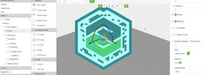

"Menu" widget can be anything as it is just studio ID which you can change in widget menu. In this case I have added 2 widgets - button and image, pasted the code I gave you to home.js, pasted 2 functions to click event of a button, and changed image ID to "menu".
Ok, thanks. I have tried on a 3D-image and it works, but unfortunately it doesn't work on a 3D-panel for Hololens.
