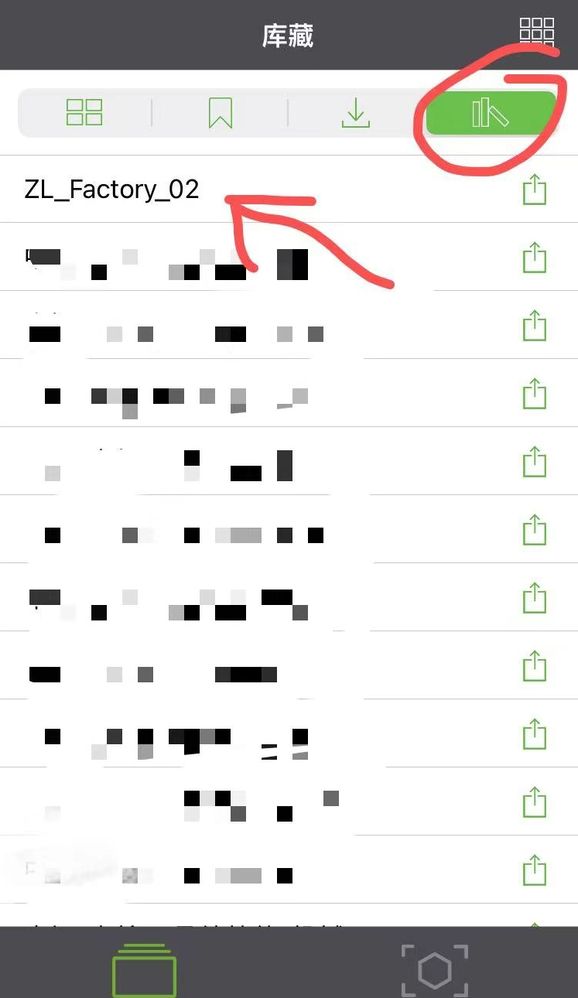

Hi All,
I published a project to Experience Service failed,but it show in Experience Service file.
Then I deleted my local project and remote Experience Service  project in (*/studio-es-store/projects).
It still stay in vuforia view library list. I have restarted ES and it doesn't work.
May I know how to delete it in view list?
Thank you.

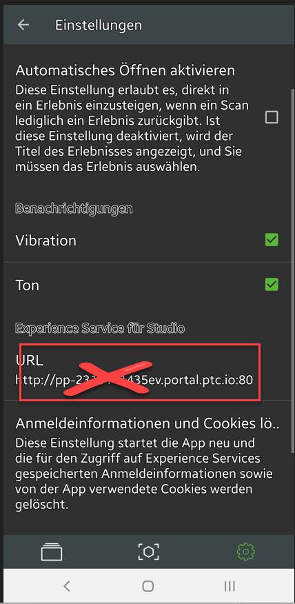

Hi @LX_10186967 ,
there is TS article "Is there any way to disable Vuforia View Library or to control the access for none ThingMark association Experiences from Library" :  which says:
  • The only way to control access of the projects in Vuforia View Library is not set the Experience Service server URL
  • The projects associated with ThingMarks are able to load on scanning a ThingMark or QR code without setting Experience Service server URL
So means you need to check the Vuforia View setting where the URL points. Possibly it points to another server which contains the same experience

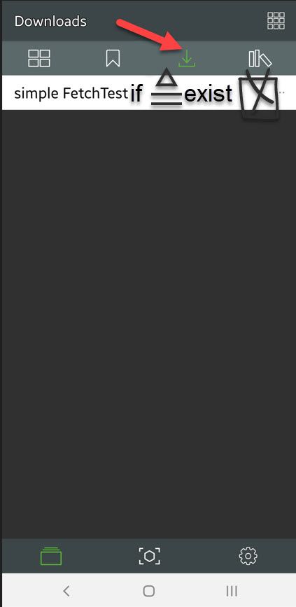

When this  does not help - possibly this was downloaded for offline use in the download tab. Then remove the experience from there. For HoloLens2 device refer to the commands for the HoloLens:

sorry for the delayed response.I created a project "test" in local Vuforia Studio, when I uploaded "test" to the ES, it failed due to possible network issues. So I  deleted the project "test" in my Vuforia Studio.
However, when I refreshed the remote server library on my mobile device(ios),  the project "test" still appeared in the Vuforia view.
Even though I deleted the files on ES and restarted the ES, it still didn't work.
Is there any way to make the project "test" in the list disappear?
