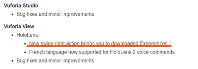

I am using Hololens II and have trying the previously new feature which is download experience.
I able to download experience and view the downloaded experience thanks to the nice documentation below.
However, for some projects it return "download experience failed" and I noticed that the failed download experience have more than 10MB file size. Just would like to know if there are limitations for experience download.
