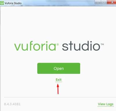

I had a BlueScreenOfDeath while working on in Vuforia Studio.  Since then, Vuforia Studio would not start.  I have rebooted, repaired and uninstalled/rebooted/reinstalled - and still have the same problem. Can someone review the logs and suggest my next steps ?

[2019-05-16T06:10:24.154Z] error: [twx-studio:builderSettingService] Could not open the builder settings file: SyntaxError: Unexpected token in JSON at position 0

Hi @MikeDSmith2,
Please take a backup of builder-settings.json file (located at C:\Users\<username>\Documents\VuforiaStudio) and delete it from the folder C:\Users\<username>\Documents\VuforiaStudio. Close all the Studio applications and stop the service by clicking on 'Exit':
Restart the Studio application. Hope this helps to resolve the issue!
