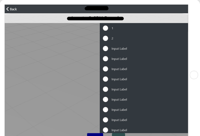

I have a list of checkbox. When I insert the checkbox using grid layout, it cannot be scroll down when i preview it. the total checkbox that i need to display is 17. but it only display 11 checkboxes on screen.
How to solve this problem?

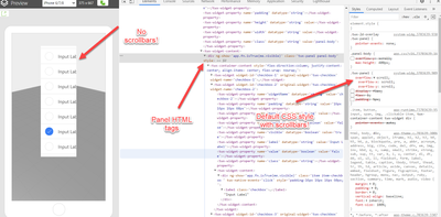

I have tried this solution but no scrollbars have been displayed even if default CSS stylesheet should display them!
It is a point to investigate deeper.
I think about a standard HMTL/CSS error.
Maybe the scrollbars are hidden by outside area.

I've tried to use the panel widget, but there's no scrollbars as you've mentioned.
