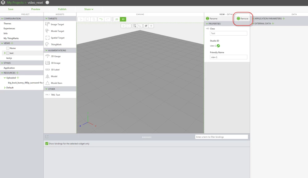

Hi there,
how can I delte an second view which I created but not use anymore?
Thanks for help!
Solved! Go to Solution.
Please follow these steps :
Best regards,
Sam
Best regards,
Sam
Do you also know how to change the name of a view?
And how to copy a view would be nice 😃
To rename a View, follow the same steps, execpt at the step 3, click the Rename button.
To copy a View, saddly this feature doesn't exist today.
Best regards,
Samuel
