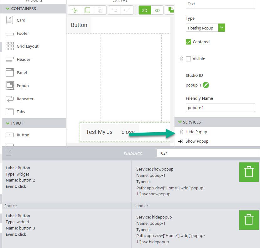

Ok thanks for the picture. I see this is popup windows- which means that this is a popup widget which could be closed by the following options:
- calling of the JS method :
 $scope.app.fn.triggerWidgetService("popup-1","hidepopup");
there is also the service showpopup which will show a popup widget.
-you can bind directly the button e.g. cancel to the hidepopup service of the popup widget:
and then in the click button event e.g. in Accept - Buttob also with javascript  check you can get the values  which are set in the popup like color Wings etc.
In the Cancel button you do not need such check but only close the popup
... But if you want that a setting in select will cause some event and this will close the popup - in this case you can call
from js callback of any event of the select or other widget.

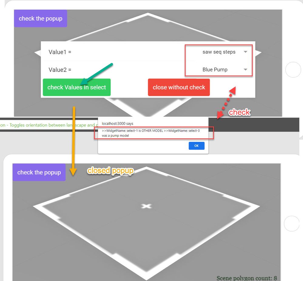

$scope is the correct variable name of the scope ! I am sorry I overlocked at the beginning so all other posts are not necessarily. Did you check you original code writing $scope ? instead of scope
if($scope.view['Home'].wdg['select-1']['value'] == " Yes"){hide("popup-Window");
Sadly its still not working. Its a Select Widget, where you can choose between different Values.
to avoid that this post will be to long , created a project so far I understood your issue and added it here So hope it will help
