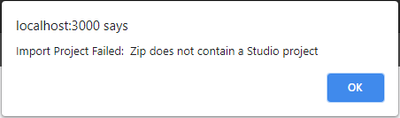

ASM
6-Contributor
6-Contributor
(To:dsgnrClarK)
got this error.
dsgnrClarK
(To:ASM)
updated
